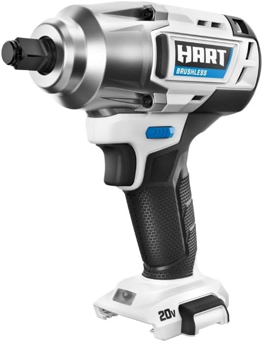

HART 20V Power Tools Battery Conversion Guide
Looking for a HART 20V battery adapter to use other brands' battery packs on your HART 20V power tools? You came to the right place. This page provides recommendation of battery adapters and various methods for you to do just that.
