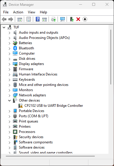

  7. Look under "Other devices" category in "Device Manager" and see if "CP2102 USB to UART Bridge Controller" shows up (see screen shot below). If so, your Windows computer is missing the device driver; please see the next "Install the Device Driver" section to install it. If you don't see that entry in "Other devices" category, follow the next step below.

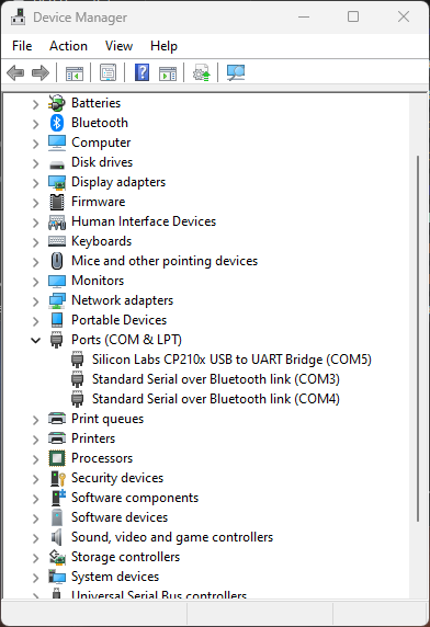

  8. Look under "Ports (COM & LPT)" category in "Device Manager" and see if "Silicon Labs CP210x USB to UART Bridge (COM5)" shows up (see screen shot below). The "COM5" could be any COM port available on your computer. If so, you already have the proper device driver; you may skip this article.

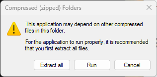

  4. After launching the installer, Windows will present the dialog in the following screen shot. The launcher will need other files in the ZIP file, so click the "Extract all" button to continue.

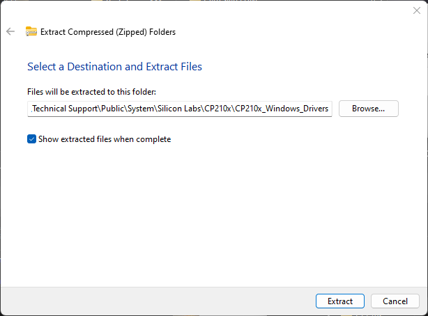

  5. Windows will ask you where to extract the files (see screen shot below). The default location is the same directory as the ZIP file, meaning it will create a new folder with the same name there. Click the "Extract" button to continue.

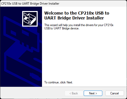

  7. You will be presented with the welcome screen as shown below. Click on the "Next >" button to continue.

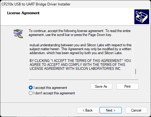

  8. You will be presented with the License Agreement as shown below. Select "I accept this agreement" and press the "Next >" button to continue.

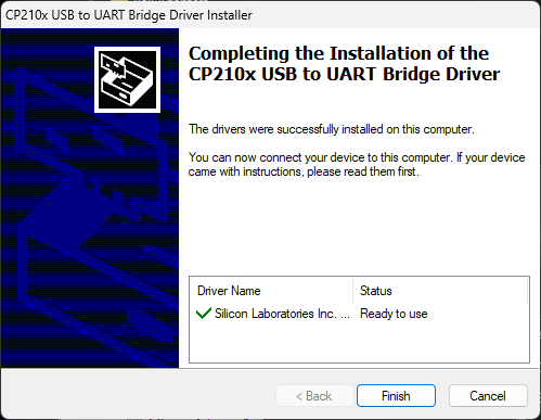

  9. Finally, the installation occurs very quick. You'll be presented with the completion screen shown below. Press the "Finish" button to continue.
At this point, if you check the "Device Manager" again, you should see Windows recognizing the device as a COM port:
