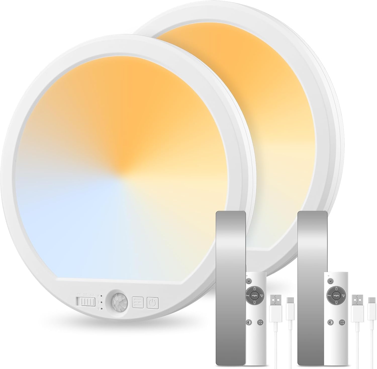

Amzpas 7" Rechargeable Motion Sensor Ceiling Light
2.06
9
Charging. Same power consumption whether the LED is on or off.

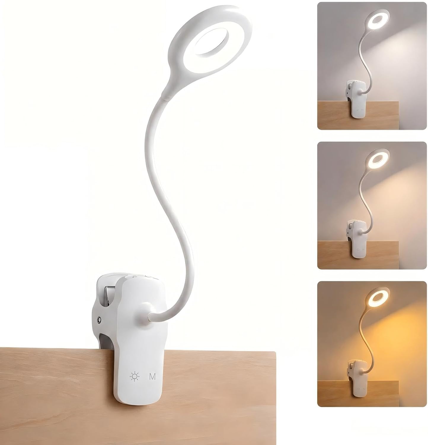

LACOKI Clip on Rechargeable Reading Light
0.5
2.42
Charging, while device is switched off
1.3
6.46
Charging, while device is full bright.
