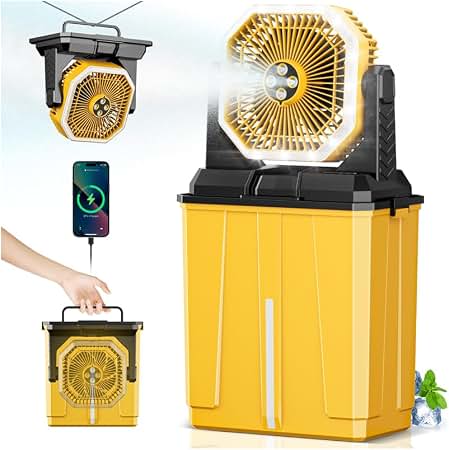

Ausic Portable Rechargeable Misting Fan
1
4.4
Charging.
1.09
4.54
Charging. Fan on low speed. Misting on continuous mode.
1.5
6.15
Charging. Fan on medium speed. Misting on continuous mode.
1.64
6.64
Charging. Fan on high speed. Misting on continuous mode.

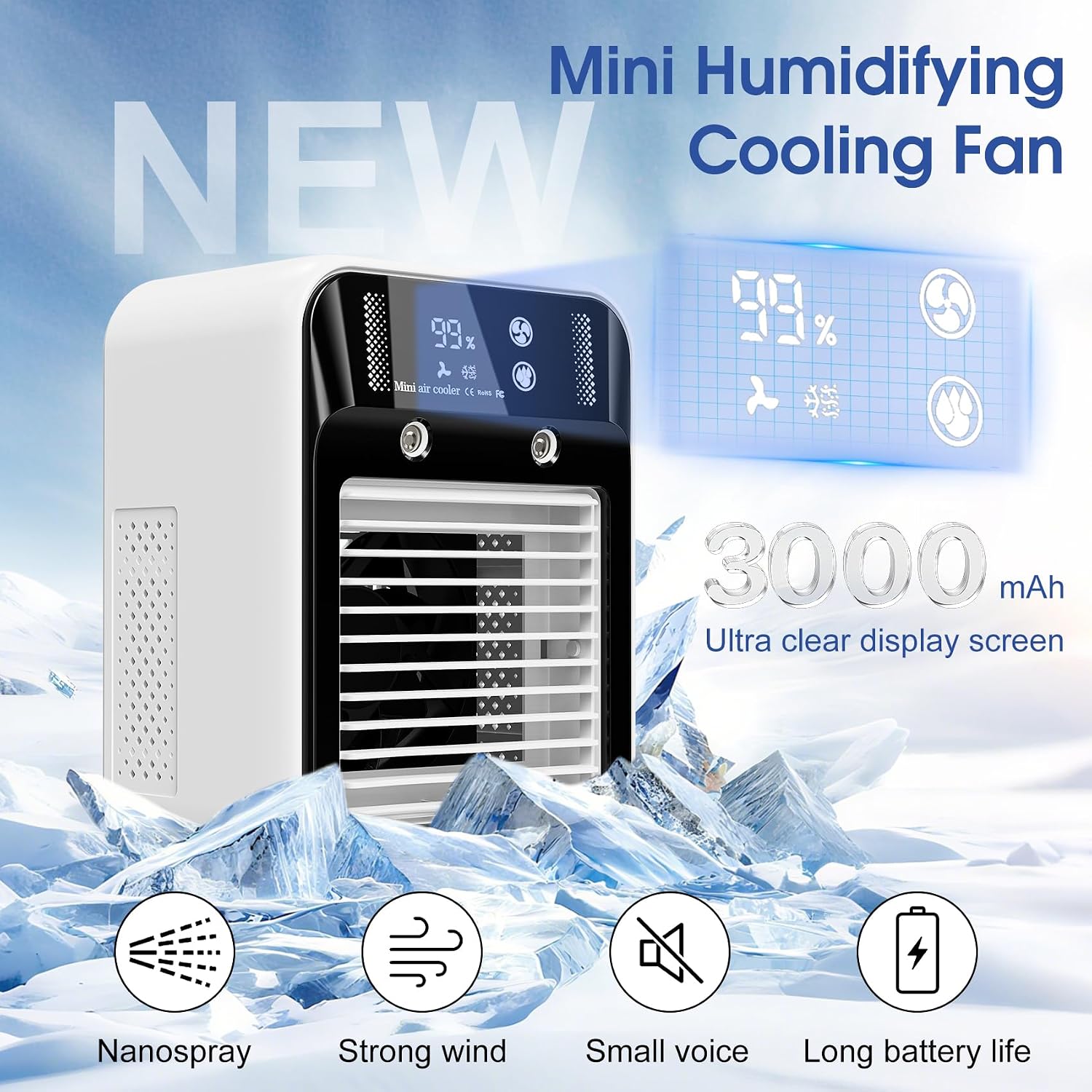

Deller Rechargeable Portable Air Conditioner
0.84
3.7
Charging.
0.76
3.44
1.26
5.3

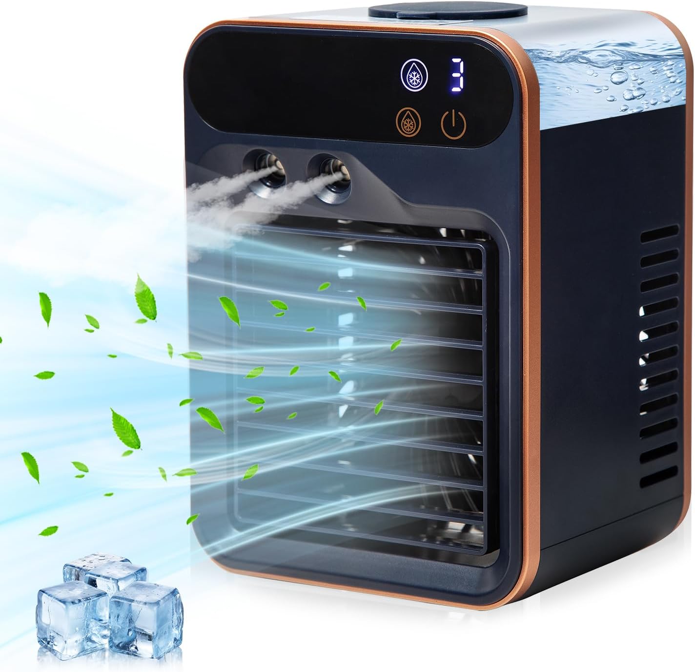

hYwecy Portable Air Conditioner
0.81
3.66
Charging.
0.82
3.69
Charging. Fan on setting 1. Mist on continuous mode.
0.82
3.69
Charging. Fan on setting 2. Mist on continuous mode.
0.82
3.69
Charging. Fan on setting 3. Mist on continuous mode.

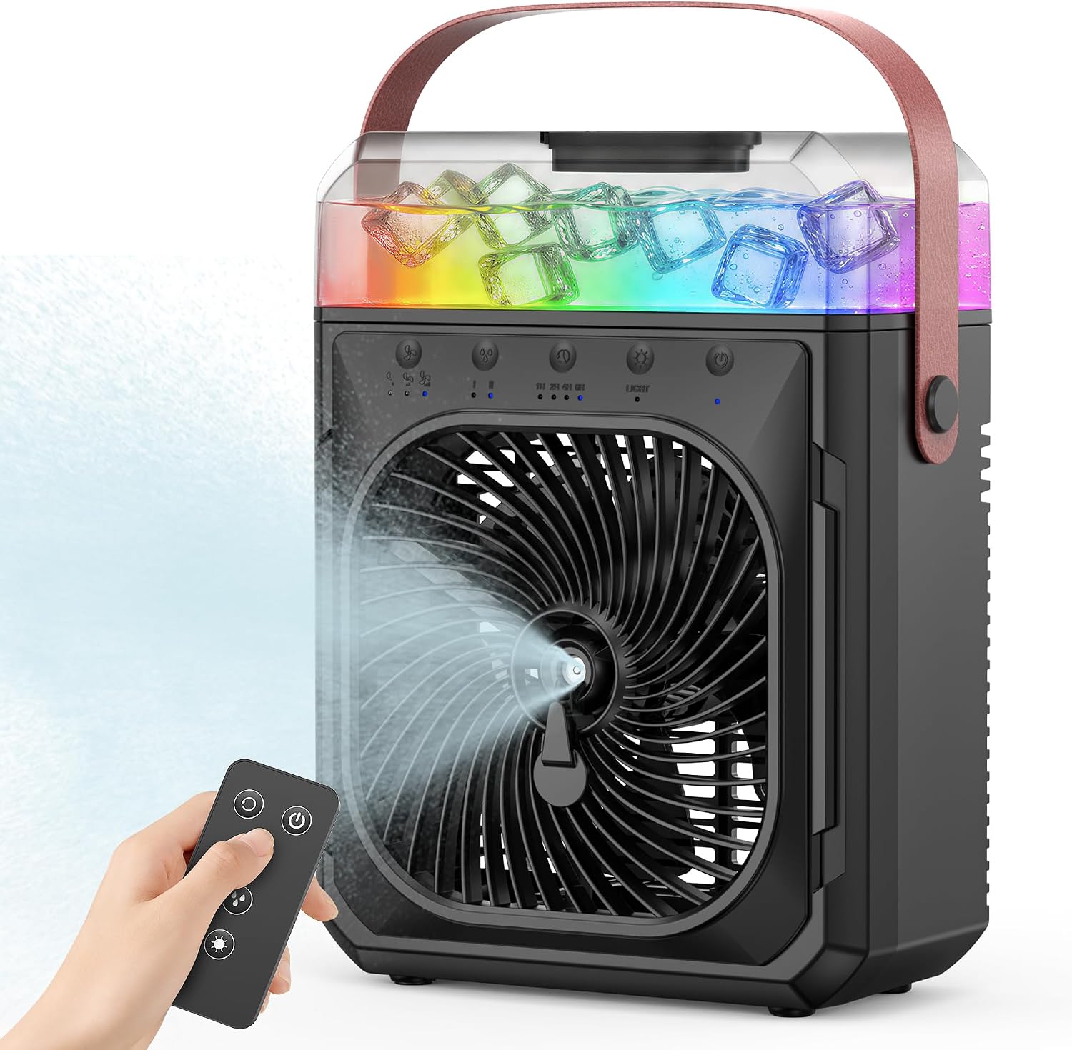

JINLICTE Portable Misting Fan
0.58
2.69
Charging.
0.59
2.73
Charging. Fan on low speed. Mist on continuous mode.
0.58
2.69
Charging. Fan on medium speed. Mist on continuous mode.
0.58
2.69
Charging. Fan on high speed. Mist on continuous mode.

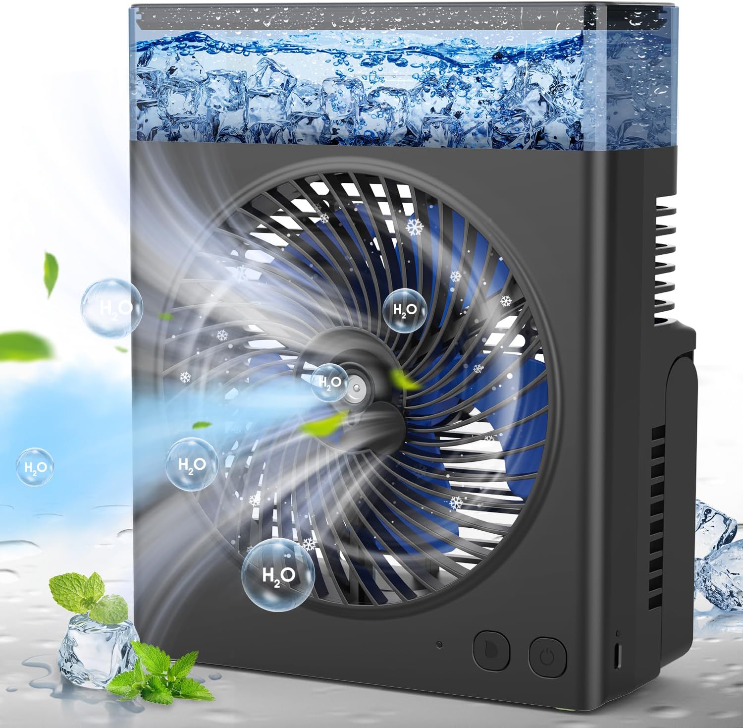

Orteen Portable Misting Fan
0.53
2.48
Charging.
0.53
2.48
Charging. Fan on low setting. Mist on continuous mode.
0.53
2.48
Charging. Fan on medium setting. Mist on continuous mode.
0.53
2.48
Charging. Fan on high setting. Mist on continuous mode.

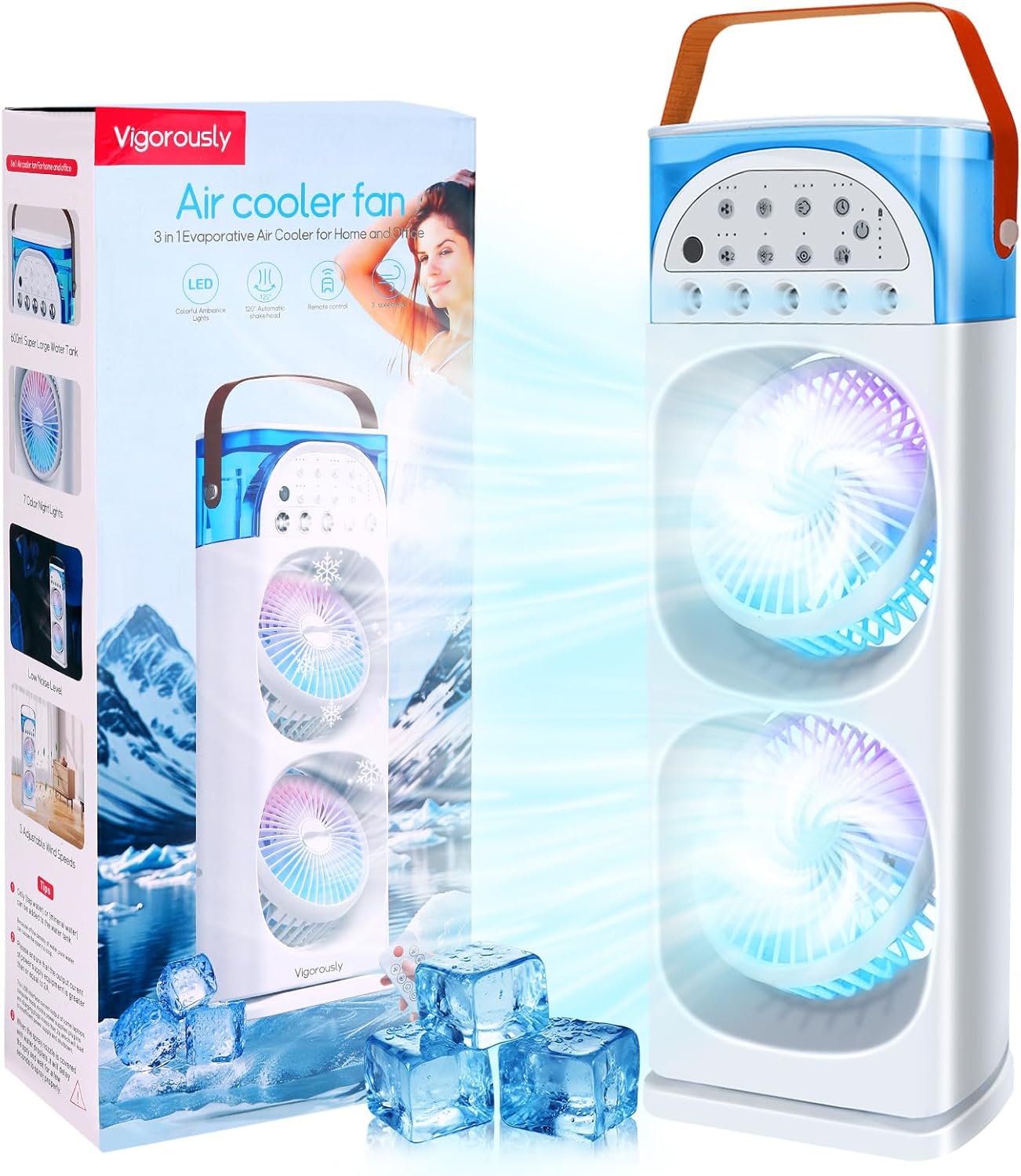

YANWEI 4-IN-1 Portable Air Conditioners
0.62
2.87
Charging.
1.13
4.9
Charging. Both fans on low setting. All 5 misting ports on continuous mode.
1.21
5.19
Charging. Both fans on medium setting. All 5 misting ports on continuous mode.
1.32
5.26
Charging. Both fans on high setting. All 5 misting ports on continuous mode.
