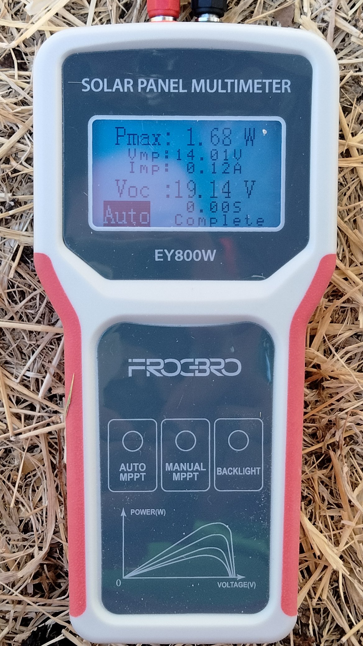

As example, we used the Solar Panel Multimeter to test a solar panel that has failed. The solar panel test tool revealed the following:
  • Voc: 19.14 volts (normal for a 100W 12V panel)
  • Isc: 0.12 amps (catastrophically low)
  • Power: ~1.68 watts
This combination is extremely telling... Normal voltage means the panel's cells are still producing electrical potential. Near‑zero current means the power path is broken or bypassed. Low wattage is simply the result of low current. When voltage is normal but current collapses, the problem is almost always a failed bypass diode or a broken cell string / ribbon inside the panel. The diode is the only part you can realistically fix yourself.

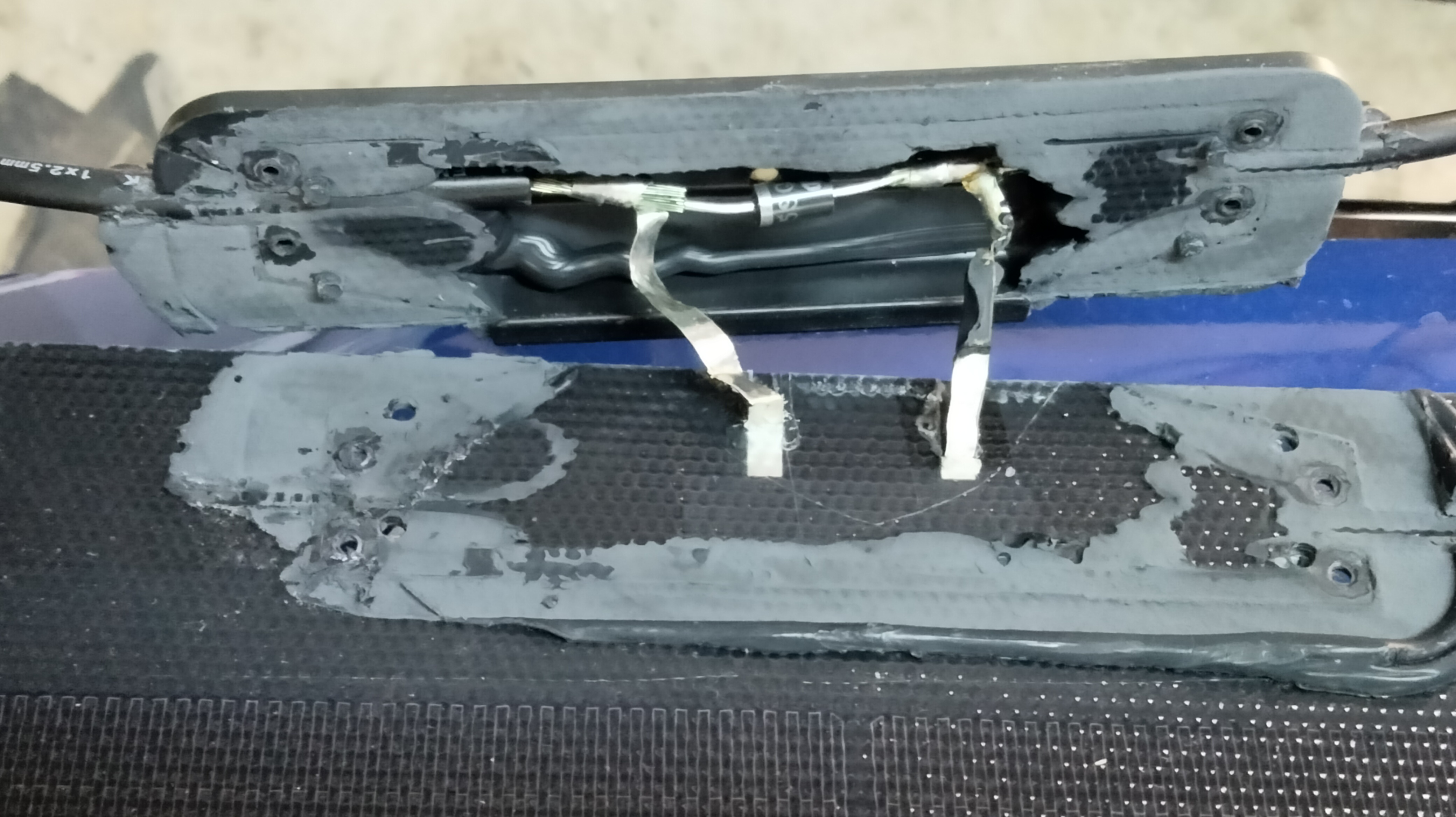

Step 2: Inspect the Junction Box and Wiring
After seeing the abnormal readings, the next step is to inspect the junction box - the small enclosure where the panel's internal cell strings connect to the output wires. Inside, you'll typically find:
  • Soldered bus bars
  • Wiring connections
  • One or more Schottky bypass diodes
First thing to check once you opened up the junction box is to see if there are any obvious failures, such as broken wire, loose connection, burnt parts. If you don't see any obvious signs of failure, it's time to check the Schottky bypass diode(s).

But 0.00V forward means the diode has failed short -- effectively acting like a wire. A shorted bypass diode permanently bypasses an entire string of solar cells. That instantly drops panel current to near zero while leaving voltage mostly intact -- exactly the symptoms measured earlier. This diode had failed internally, causing the entire panel to behave like a 2‑watt trickle charger instead of a 100‑watt module.
