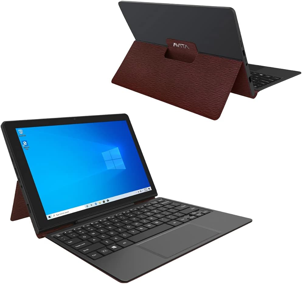

Avita Magus II WT9M10 C44-BG
0.04
3
Charging 7% battery. Idle in Best Performance mode. Whether keyboard is attached makes no difference in power consumption.
0.12
9
Idle in Best Performance mode. 100% battery. Keyboard not attached.
0.17
13
Charging. Sleeping. Whether keyboard is attached makes no difference in power consumption.
0.06
4
Sleeping. 100% battery. Keyboard not attached.
0.14
10
100% CPU running MinerGate to mine Monero (XMR). Whether keyboard is attached makes no difference in power consumption.

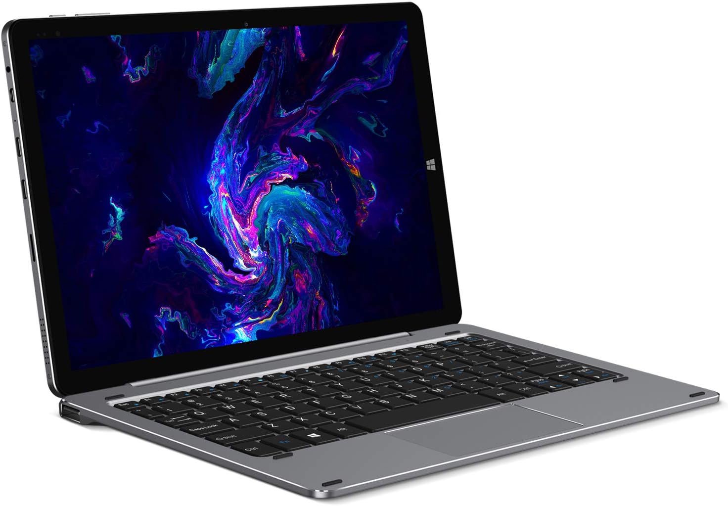

Chuwi Hi10 X
0.33
23
Idle in Best Performance mode. Charging 67% battery. Keyboard not attached.
Chuwi Hi10 X
0.23
16
Chuwi Hi10 X
0.36
25
100% CPU running MinerGate to mine Monero (XMR). Best performance mode and better performance mode makes no difference in power consumption. Whether keyboard is attached makes no difference in power consumption.

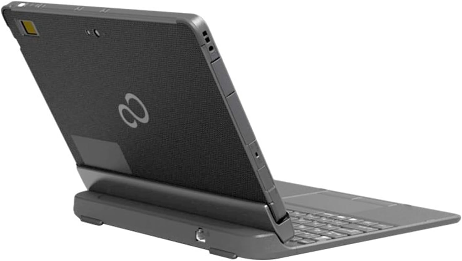

Fujitsu ARROWS Tab MQ10A
0.233
16.6
Charging while tablet is powered off.
0.366
26.8
Charging while tablet is powered on.
0.122
7.3
Running.

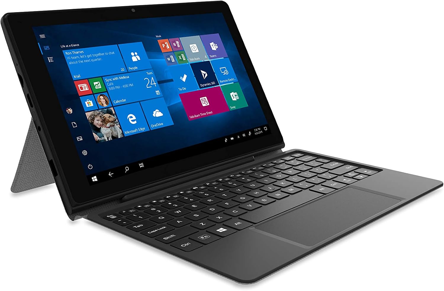

Insignia FLEX NS-P10W8100
0.49
2.4
100% Battery. Idle in Better Performance mode. Keyboard not attached. Display dimmed all the way.
0.22
16
Charging. Idle in Best Performance mode. Whether keyboard is attached makes no difference in power consumption.
0.2
15
Charging. Sleeping. Keyboard attached.
0.18
14
Charging. Sleeping. Keyboard not attached.

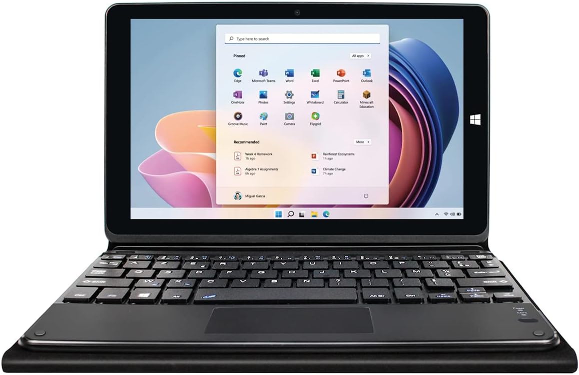

NuVision TM800W610L
0.01
1
Booting. 100% battery.
NuVision TM800W610L
0.03
1
NuVision TM800W610L
0.01
1
