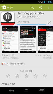

Getting the App
The "Harmony pour T�l�7" app is available on Google Play. We simply searched for "Logitech Harmony" and it popped right up. The screen shot below shows the "Harmony pour T�l�7" app page in Google Play on our Android device.

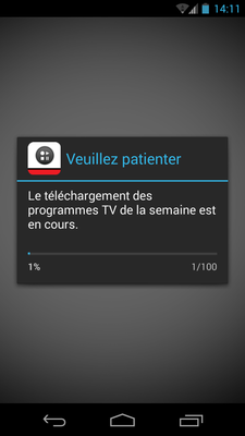

Initialization
The first time you start the app, it's going to download all of the T�l�7 channels (see screen shot below). It takes a few minutes, depending on your network connection. There is no way around it. So just let it run its course.

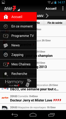

After the app has initialized the first time--it won't need to initialize every time you use it--you will be presented with the T�l�7 channels. Tap the "T�l�7" menu pull-down, on the top left corner, to reveal its menu options (see screen shot below).

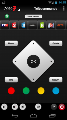

The last option in the menu is the "Harmony" activity. Tap the last option. The activity will switch to the default remote control (see screen shot below).

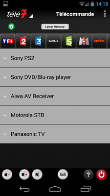

You can swipe the screen to change the default remote functions. Maybe that's all you need. But if you want access to individual remote controls, swipe all the way to the right. That will reveal all of the remote controls available on the Harmony Hub (see screen shot below).

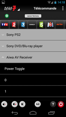

Tap the remote control you want to use to reveal all of its button functions (see screen show below). Scroll up and down to see all of the button functions. Tap on the function to activate the button. In a way, this final remote control interface is actually faster and more intuitive than the actual "Harmony" app.
