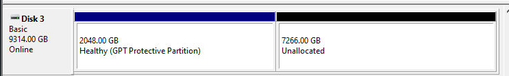

I have a HGST 0F27488 Ultra 9.77 TB SATA Hard Drive that I've placed into a Seagate Expansion Desktop Drive SRD00F2 external enclosure. The case was made for a 4TB SATA HDD. It formatted the 10TB drive just fine and I've been using it for many years now.
Today, I took the drive out of the enclosure. I put it into a SATA USB docking station and turned it on. Disk Management in Windows shows the drive online with 2 partitions:
  1. Disk 3 Basic 9414.00 GB Online
  2. 2048.00 GB Healthy (GPT Protective Partition)
  3. 7266.00 GB Unallocated
But it wouldn't let me do anything with the drive or any of the partitions. Right-clicking on each partition and the drive itself shows a menu with everything disabled other than "Properties" and "Help". It wouldn't let me re-partition, format, or delete partition.
What is happening here?
